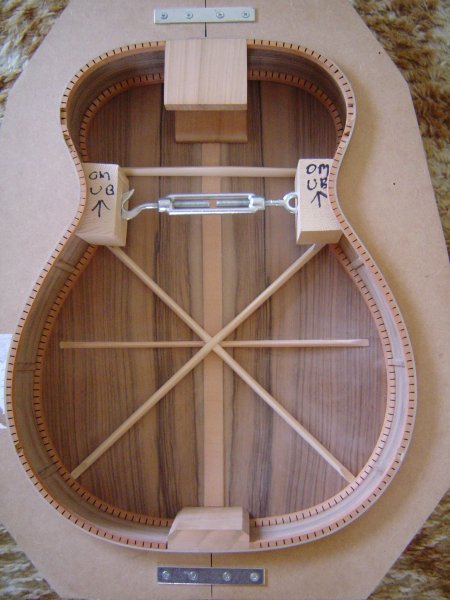

This is one that I've just glued up yesterday.
I thought that I had some picts of ones that I've carved, but not so. I found that the back really holds the dome much better braced like this. The braces are all 7 mm X 15 mm and will be thinned considerably. This is the first back that I've added the small finger braces in the lower bout. I'll shave them down a fair bit.
Hope that this helps.

Thanks Allen, that helps alot. Just needed some idea of positioning of the
cross brace.

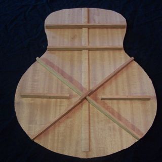

Here's one Martin.
There was a thread about 6-9months ago which had loads of X-braced backs. Search in the archive.

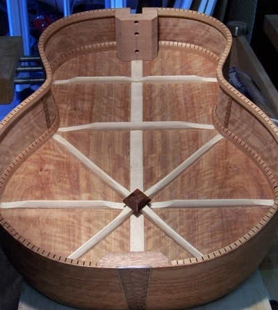

One of mine.
